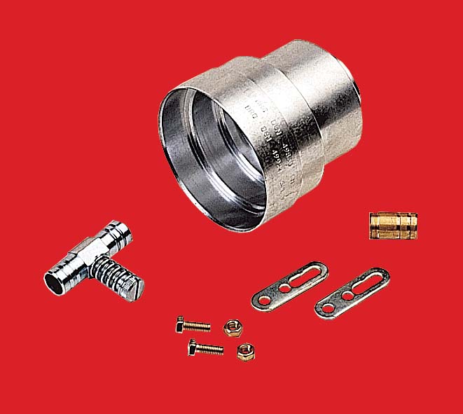

WITAM WSZYSTKICH FANOW FORDA PROBE
NIEJEST PRAWDA ZE NIEDA SIE ZALOZYC INSTALACJI II-GENERACJI
DO PROBE I ZE NIEMA INSTALACJI BRC DO TAKIEGO BOLIDA
JEST INSTALACJA II-GEN ORAZ ORGINALNY MIKSER SPECJALNIE DO TEGO AUTA
PROBLEM ZAS POLEGA NA TYM ZE AUTA KTORE TRAFIAJA DO MNIE DO ZAGAZOWANIA CZESTO SA W OPLAKANYM STANIE (UKLAD ZAPLONOWY)
A WLASCICIEL JAK USLYSZY ILE KOSZTUJA NOWE KABLE WYSOKIEGO NAPIECIA ,KOPULKA, PALEC TO MOZNA SIE DOMYSLIC JAK REAGUJE
A JAK ZNAM ZYCIE TO NIKT NIE KUPUJE PROBASA ZEBY JEZDZIC SPOKOJNIE ,NOI KOLO SIE ZAMYKA
A STRZALY MOGA BYC POTEZNE I ICH KONSEKWENCJE TEZ
BO BARDZO CIEZKO ZABESPIETRZYC TEN SILNIK PRZED STRZALAMI
(2500 V6) ALE POZATY CHODZI PIEKNIE
POZATYM JEZELI MACIE JAKIES KONKRETNE PYTANIA TO CHETNIE POMOGE MOJ E-MEIL oleksyk@czakram.pl
POZDRAWIAM WSZYSTKICH I PRZEPRASZAM ZE SIE WTRACILEM ALE
ZNAJOMEK DAL MI CYNK ZE SA TU PORUSZANE SPRAWY GAZU I ZE NAWET PADLO MOJE NAZWISKO WIEC SIE ODEZWALEM
NO TO CHYBA TYLE
PIOTR OLEKSYK CZAKRAM BRC TARNOW

DLA ZAINTERESOWANYCH PRZESYLAM ZDJECIE MIXERA[img]http://www.czakram.pl/produkty/12mx_/12mx00250002-.jpg
