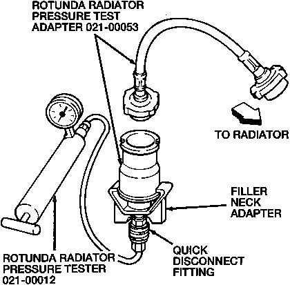

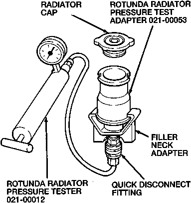

Robert pisze:... nie jest w niej powiedziane, co oznacza ten zakres, w samym opisie testowania korek ma utrzymać takie ciśnienie a potem spuszcza się powietrze przez zawór na mierniku...
Nie wiem. Choć ja skłaniałbym się do takiej właśnie interpretacji p.p. 6, 7 i 9.
  1. Remove the radiator pressure cap.
  2. Install Rotunda Radiator Pressure Test Adapter 021-00053 or equivalent, onto the filler neck adapter.
  3. Use tap water to clean the radiator pressure cap rubber seal and vacuum relief valve.
  4. Install the radiator pressure cap onto the radiator cap pressure test adapter.
  5. Connect the female quick disconnect fitting of Rotunda Radiator Pressure Tester 021-00012 or equivalent to the male quick disconnect fitting of the filler neck adapter.
    NOTE:
    If the plunger of the tester is depressed too fast, a false pressure reading will result.
  6. Slowly depress the plunger of the tester until the pressure gauge reaches 74-102 kPa (10.7-14.9 psi).
  7. Verify the radiator pressure cap maintains pressure.
  8. Release the pressure by depressing the relief valve on the underside of the tester.
  9. Repeat the test at least twice to verify that the pressure reading is acceptable and consistent. If the radiator cap pressure is less than or greater than the specified value, replace the radiator cap.
Jak wspomniałem, reszta jest już jednoznaczna:
If no problem is found with the vehicle inspection and the radiator pressure cap testing, and there is a coolant loss, the cooling system pressure test should be performed.
  1. Make sure the engine is cool before performing the test.
  2. Connect Rotunda Radiator Pressure Test Adapter 021-00053 to the Rotunda Radiator Pressure Tester 021-00012 or equivalents, using the quick disconnect fitting.
  3. Connect the filler neck adapter to the radiator cap pressure test adapter.
  4. Connect the adapter to the radiator filler neck.
    CAUTION:
    Do not pressurize the system above the given specification.
    NOTE:
    Check the filler cap on the RH side of the engine for leakage when pressurizing the system. Check the rubber seal and relief valve on the radiator filler cap and the filler neck for rust or damage.
  5. Pressurize the cooling system to 102 kPa (14.9 psi).
  6. Observe the pressure gauge for approximately two minutes.
  7. Release the system pressure by depressing the relief valve on the underside of the tester.

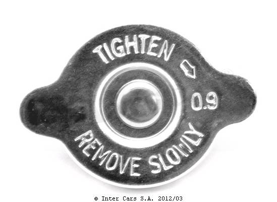

Mam pytanko. Nie orientujecie się czy korek firmy VERNET na stronach Intercarsu będzie pasować do chłodnicy w 2.0 2.5? Bo z Tico na 100% pasi tylko ciężko dostać nowy a są z tej firmy w miarę tanie o numerze VERC0050. A tak wogóle to z czego oprócz Tico będą pasować korki do chłodnicy? Przetestował już ktoś ten temat?
Jeszcze z JC znalazłem coś takiego ale nie wiem czy to będzie pasowało: D30001JC.
Pozdrawiam.
P.S. Korek wygląda jak w załączniku.

Ja korek od Tico kupowałem do 2.2 GT. W maździe mają i kosztuje około 60-80 zł. Ten na zbiorniczku przy chłodnicy jest okrągły bez tych "boczków". Ostatnio 2Ya podesłał mi koreczek i jest na nim napisane Motorcraft więc podejrzewam, że we Fordzie też będą mieli, a z tego co się dowiedziałem w Maździe, ford ma te korki tańsze.

Ja w 2.0 mam z Tico i pasi. Tylko teraz są trudno dostępne. A chodzi mi konkretnie czy te Vernet albo JC będą pasowały bo są w miarę tanie i są dostępne. Tzn. chodzi mi o to czy będą miały dobrą średnicę. I czy może być korek 0.9 czy 1.1 bara?
