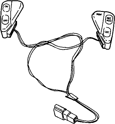

Podpinając się pod wątek:
jak wygląda sterowanie tempomatem przy kierownicy?
Najlepiej jakaś fotka by się przydała, a jak nie da rady to chociaż powiedzcie jakie napisy widnieją na tych przyciskach?

Tak wygląda te sterowanie tempomatem http://www.fotosik.pl/pokaz_obrazek/pel ... 2840b.html
Ford Sierra 2.0i DOHC CLX 91r.
Ford Probe II 2.5 GT z LPG 94r.
Ford Mondeo Kombi 1.8 16V GLX 95r.
:arrow: http://www.performanceprobe.com/info/op ... nt_scs.htm
1) Speed Control On (ON)
Press the On button to turn the Speed Control System on. Note: The Speed Control System will be turned off automatically when the ignition is turned off.
2) Speed Control Off (OFF)
Press the Off button to turn the Speed Control System off. Note: The Speed Control System will be turned off automatically when the ignition is turned off.
3) Resume (RSM)
If you press the brake pedal or the clutch pedal while the Speed Control System is on, the system will be suspended. To return to the speed you had set, press and hold Resume for approximately one second and then release. The vehicle will gradually return to the previously set speed and then maintain it. Note: To resume the speed you had before, you must be driving at least 30 mph (48 km/h).
4) Set Acceleration (SET ACC)
The Set Acceleration button allows you to set the Speed Control System's programmed speed. To set:
Press the Speed Control On button (1).
Accelerate to the desired speed. The speed must be at least 30 mph (48 km/h) in order for the Speed Control System to activate.
Once at the desired speed, press the Set Acceleration button to set the current speed.
Take your foot off the accelerator pedal. Your vehicle should maintain the speed you set.
When the vehicle speed is set, you can reset the Speed Control System to a higher speed using the Set Acceleration button. Press and hold the Set Acceleration button until the vehicle accelerates to the desired speed, then release the button.
Note: If you want to momentarily accelerate to a higher speed, manually accelerate using the accelerator pedal. This will not interfere with the set speed. When you take your foot off the accelerator pedal, the vehicle will return to the set speed.
Note: Do not shift to Neutral when using the speed control. This will cause the engine to overspeed.
Note: To suspend the Speed Control System and regain control over the vehicle's speed, press the brake pedal or the clutch pedal. You can then resume to the set speed by using the Resume button (3).
Note: When driving up a hill, especially with a heavy load, significant speed drops may occur. If the speed drops more than 8 to 14 mph (13-23 km/h), the Speed Control System will automatically cancel.
5) Coast (CST)
The Coast button allows you to reset the Speed Control System to a lower speed. To reset to a lower speed, press and hold the Coast button until the vehicle slows to the desired speed, then release. The set speed will be set where you released the Coast button.
Jedynki tutaj: :arrow: http://www.performanceprobe.com/info/op ... nt_scs.htm

Nie mam pojęcia (nie rozbierałem, bo nie mam 2), ale tu masz procedurę testową przełączników tempomatu, więc kombinuj:
  • Wyłącz prąd (wyjmij kluczyk).
  • Rozłącz wtyczkę przełącznika tempomatu (wewnątrz kierownicy / uwaga na poduchę, bo nie wiem, czy można dostać się do wtyczki bez jej zdejmowania, więc jeśli nie, to zalecane jest wcześniejsze odłączenie akumulatora).
  • Zmierz oporność pomiędzy stykami 3 i 2. Obrazek
    Prawidłowe wartości:<pre> włączenie (ON) :arrow: > 10 kΩ
    wyłączenie (OFF) :arrow: < 5 Ω
    ustawianie prędkości (SET/ACC) :arrow: ~680 Ω
    zwalnianie (CST) :arrow: ~120 Ω
    powrót do prędkości ustalonej (RSM) :arrow: ~2,2 kΩ</pre>
